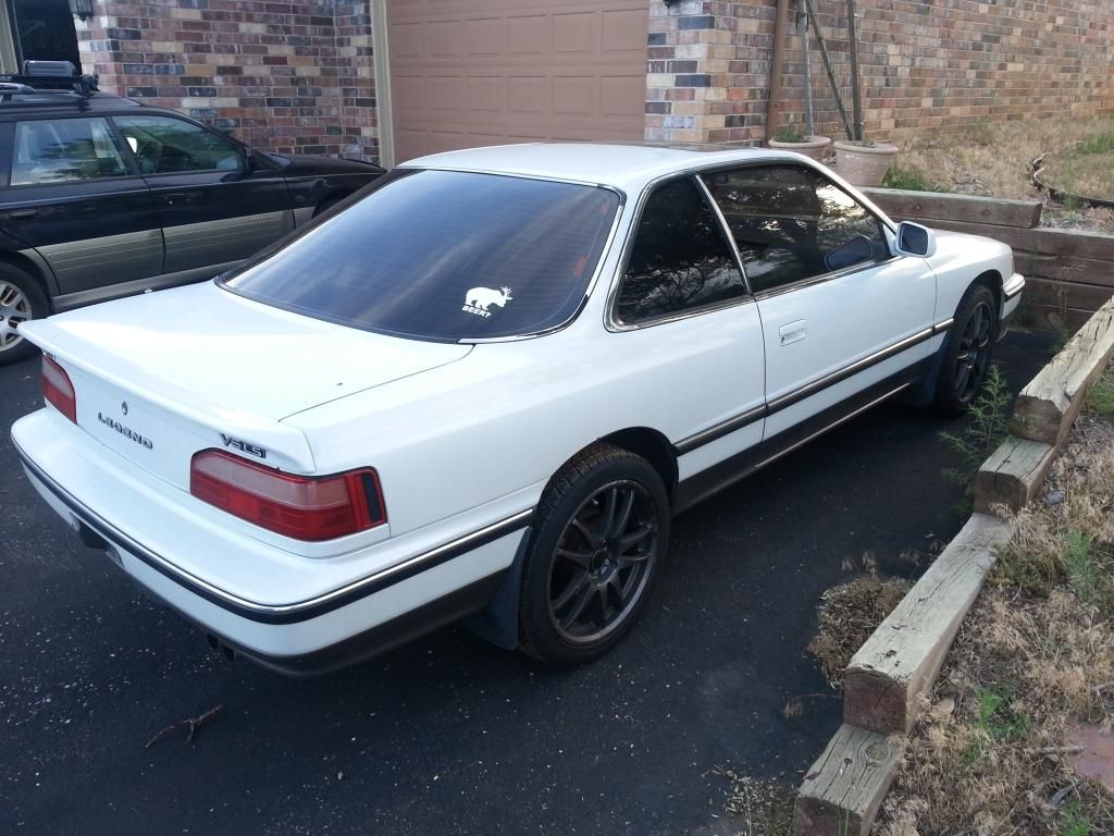

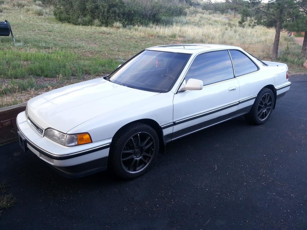

Greetings G1 guys! I just brought home a G1 Coupe tonight to add to my family. Absolute best thing is, I got it for free!!! I first saw this guy about two months ago and noticed how nice the coupe was. Then, a few weeks ago I saw him again. This time I flagged him down so I could check it out. It was just about as nice as it looked the first time I saw it. I told him if he ever wanted to sell it to give me a call and never expected to hear from him again. This morning, he text me... Told me the tranny was blown and that if I wanted it I had to come and get it today. Luckily I have a truck and access to all kinds of trailers so I met him after work, loaded it on the trailer and brought it home.
So without further delay...
http://i780.photobucket.com/albums/y...psf6def845.jpg
http://i780.photobucket.com/albums/y...ps61cab810.jpg

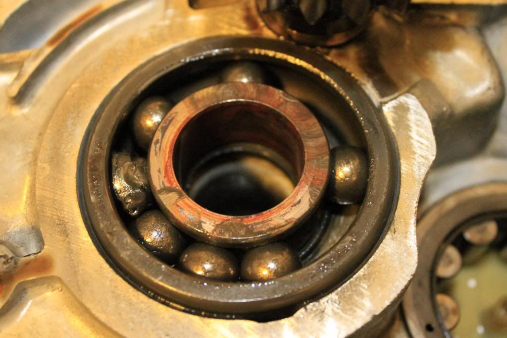

I swapped mine to 5 speed from auto and my first 5 speed did what your describing when I blew that one. Lasted only a month and pressure plate was resurfaced and torqued to spec as we'll as new clutch, pressure plate and throw out bearing. It was like a fight getting it out of gear, thought I was going to break the linkage. So I ended up putting in a different 5 speed without touching clutch and assembly and was fixed. Also took apart the old trans to see what happened and bearings were shaved.
Look at the one on the left. I didn't remove any bearings either that's how I found it, scrap metals all in the casing.

Damn! That's total failure!
Got a quote from a local, very reputable tranny shop of $500 for a complete rebuild. Supposedly that's worst case scenario with me taking the trans to them. I can handle that!

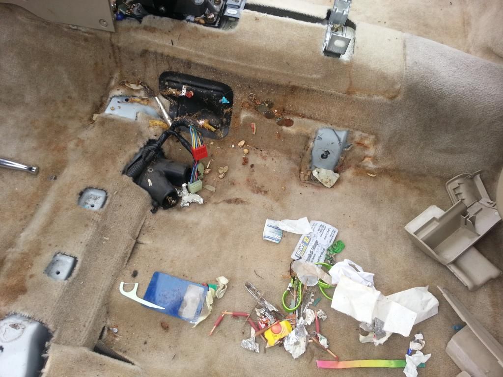

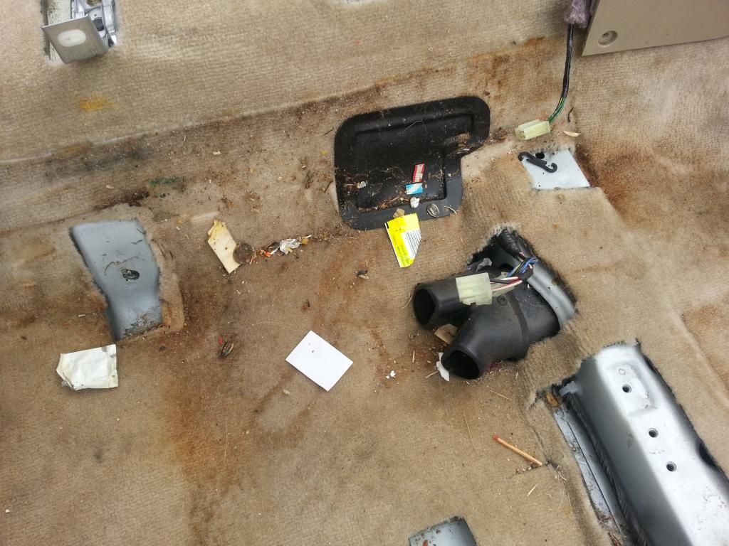

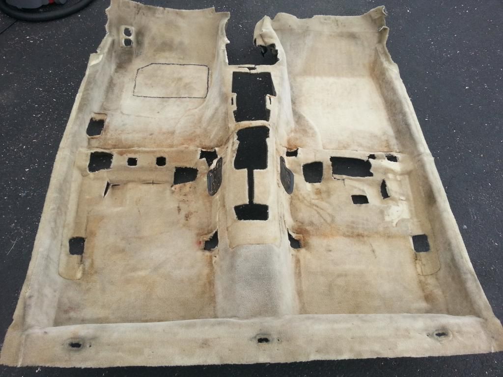

On another note, my son and I pulled all of the seats, center console and carpet on Sunday. I scrubbed and pressure washed the carpet Monday after work. Here are some before pics (I'll post after pics once the carpet has completely dried):
Driver's side and backseat garbage
http://i780.photobucket.com/albums/y...pssflzc2pc.jpg
Passenger side
http://i780.photobucket.com/albums/y...psvte5mhuk.jpg
Carpet removed
http://i780.photobucket.com/albums/y...ps9klzb5dg.jpg
Btw, I'll be posting all future progress pics in a build thread!
