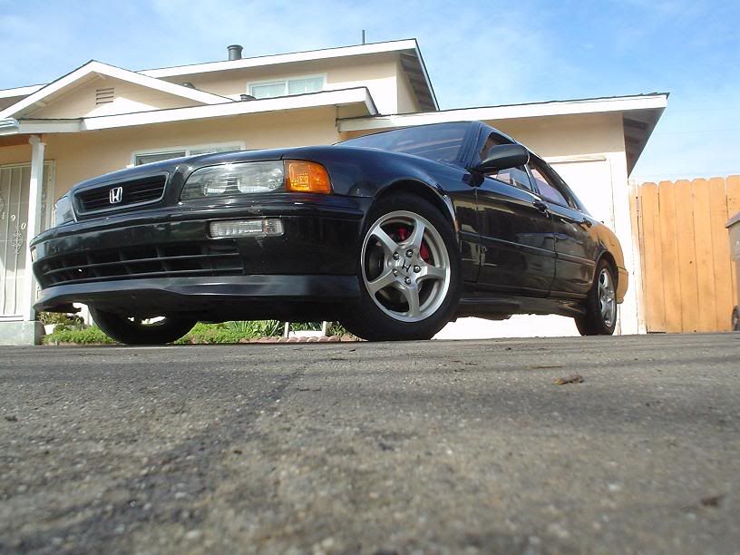

Everyone I know that puts a legend lip on their accord says it's the coupe. I've put a coupe lip on an accord. The one from the 91-93 coupe wraps around completely, the sedan lip is too short on the side and it doesn't line up and leaves a gap.
This is the diy I had bookmarked from when we did it.
Edit: found this
Legend Lips...
You have the 91-93 Legends:
91-93 Legend Sedan
-Lip is ≈1" longer, leaving .5" uncovered on each end of the CB bumper.
-Mouth is not beveled, meaning the mouth doesn't line up with the CB bumper mouth.
91-93 Legend Coupe
-Fits CB bumper just right.
-Mouth is beveled, making the transition between bumper and lip flow somewhat coherently.
Then you have the 94-95 Legends:
94-95 Legend Sedan
-Mouth is wider on 94-95 Legend Coupe because it doesn't have fog lights.
94-95 Legend Coupe
-Lip is ≈1" longer, leaving .5" extra at each end of the CB bumper.
-This model has fog lights that mount halfway in the bumper, and halfway into the lip.
Therefore, it has secondary holes after the mouth making it look "aggressive."
