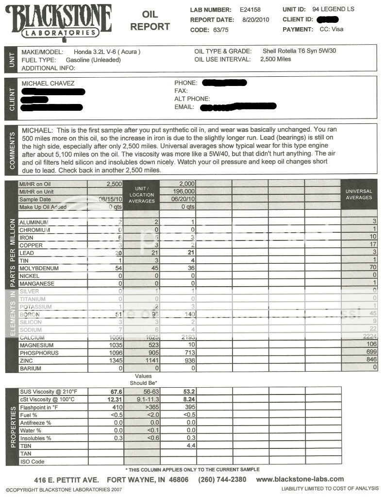

I'm curious if any of you guys have done any oil analysis? I have used Blackstone as cited in the article in the hope of pinning down a proper oil change interval. Using full synthetic, they still suggest my oil changes be performed every 2,500 miles or so because of increased lead content in my oil (they say from bearings). I have shown my reports to Dr. Dave, the resident oil expert, and he was not concerned with the lead numbers and we are currently trying a longer interval to see how the numbers change. Here is my latest report:
I would highly suggest doing a series of analysis, they are very useful.

You've touched upon one of the things about the Legend that makes it last so long. The Rod Bearings DO contain Pb (lead) unlike most cars during that era. That is why we almost NEVER see rod bearings go bad.
