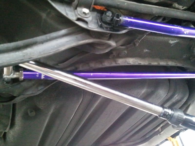

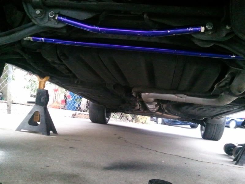

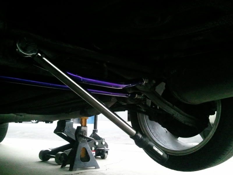

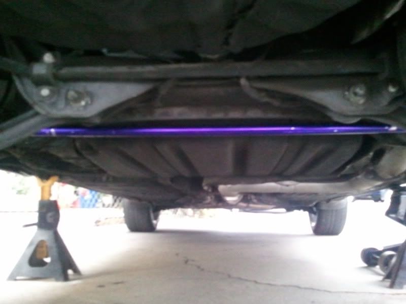

i really felt the difference with these bars turns feel so much better and the rear feels tight when turning in semi high speeds thanks for creating these telion and thanks to dat93legend for selling me these bars!!!

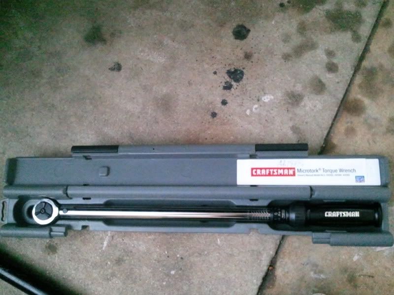

use this trusty tool to torque down the specs!!

dont know it might just be me but i noticed a little change on the stance it seems more closed!!???

Looks good man! Hopefully you didn't change the toe setting when you put the bars on.

uummm i dont think so cuz the washers and everything stayed in place

Rear toe is adjusted by an eccentric bolt. By simply rotating it to the wrong location you messed up toe
If those are bolted to the toe adjustment bolts then I'm positive you have disturbed toe.

Ya the bolts that hold the shorter bar on dictates how much toe you are running. If you were careful, then most likely you didn't ruin you toe setting.

i folowed everything as said i marked the arear where the nut was and placed it right over it check carefully and it didnt move??

I can attest that even after marking where the rear toe is set, the rear toe will be off slightly. Mine was off by a hair on both sides, I would definitely recommend an alignment.
