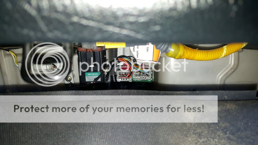

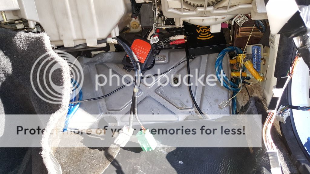

So about 2/3 of the way putting in EEV's replacement dash harness I made an unsettling discovery. My GS' harness was NOT the same as the GS donor car's harness. Mine had THREE plugs and the donor had only two.
Mine is the right one and the donor one to the left. There are TWO plugs that go over the bracket over the cabin filter. And so the replacement harness didn't have a connector to the green plug in this picture. hgeez:
My spare dash that came from an L model has the same two plugs as the one I have from the donor GS. Interestingly from my spy photo from my 93 LS Coupe it looks like it has those three plugs.

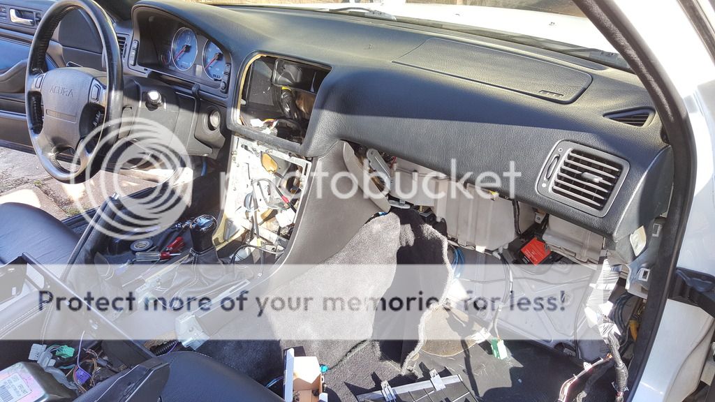

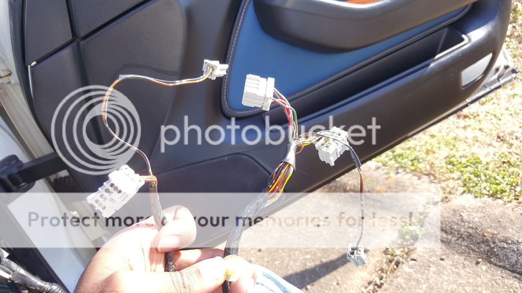

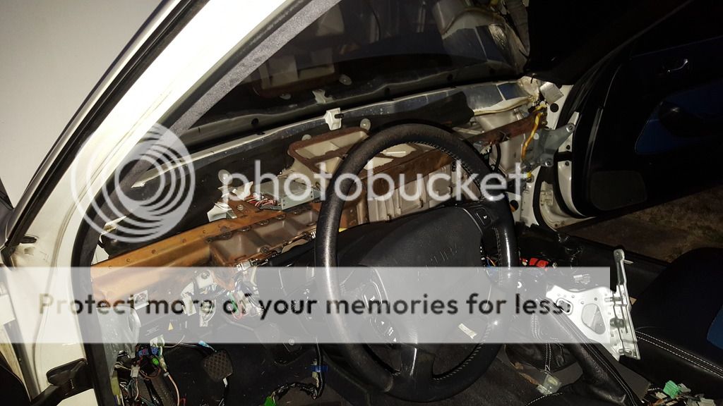

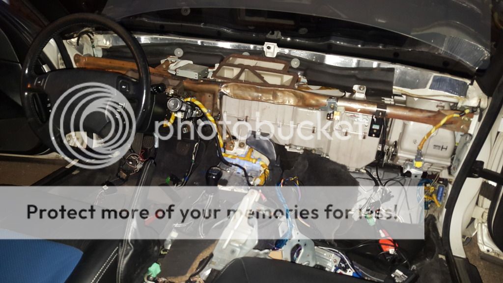

It may not look like I was pretty far along after all of the wire tracing and seeing what those "mother-busters" cut up all over a now 9 year old dvd player but here are some comparison shots.
Completely disassembled
Driver's side completely reassembled.
Unfortunately I'm going to have to disassemble what I had already gotten back together.
