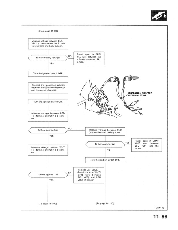

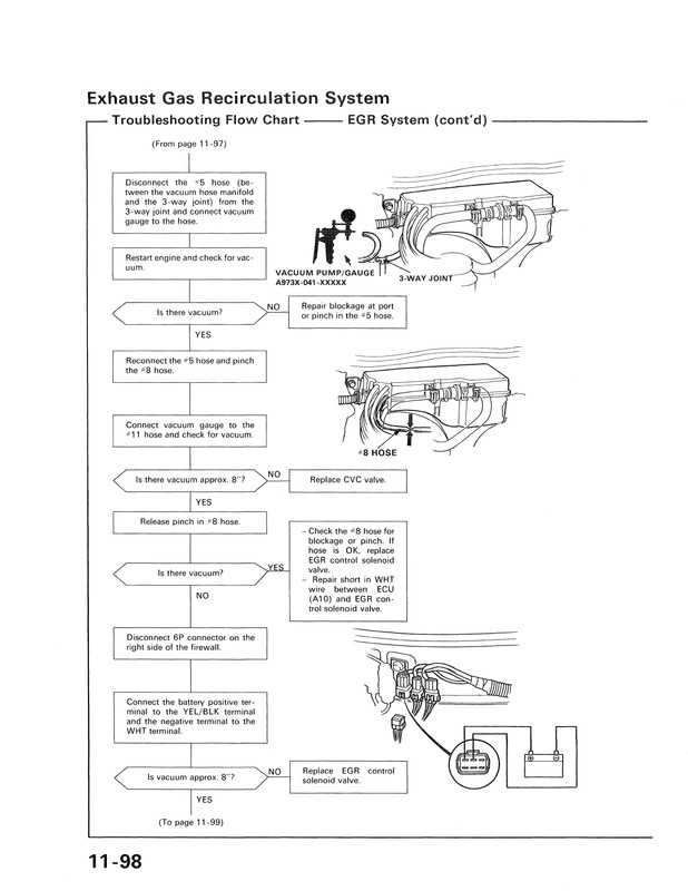

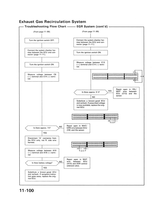

Old 01-15-2022, 04:00 PM   #5
paulo57509
paulo57509's Avatar
Location: CA
Posts: 807
paulo57509 is on a distinguished road
Hopefully, these will help.
[IMG][/IMG]
[IMG][/IMG]
[IMG][/IMG]
[IMG][/IMG]
