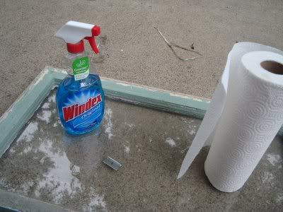

Items needed:
Krylon Stained Glass Window Spray Paint (amber)
Masking tape (i like the blue)
Windex & papertowels
Step 1:
Remove lenses/lights from car and clean everything that you plan on painting. I used windex and it worked fine.

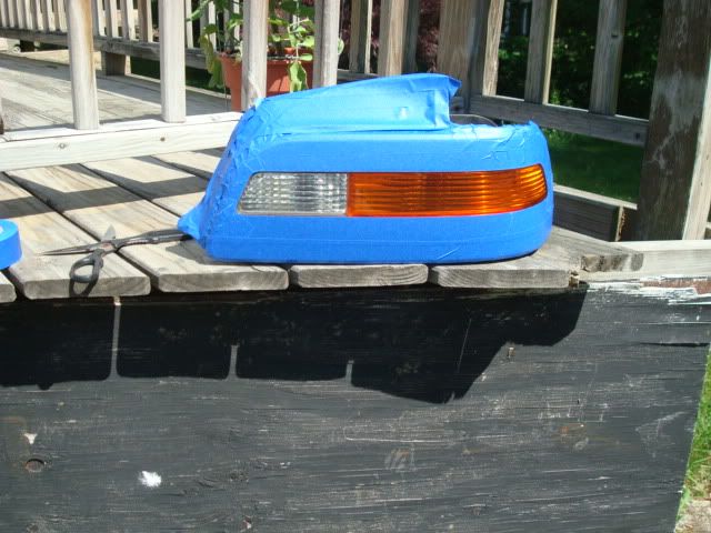

Step 2:
Tape off the areas you DO NOT want to get paint/overspray on.
Step 3:
Apply first coat of paint. Make sure you evenly spray the entire surface. Do not let it drip and do not put it on too thick. Just enough so that it covers smoothly.

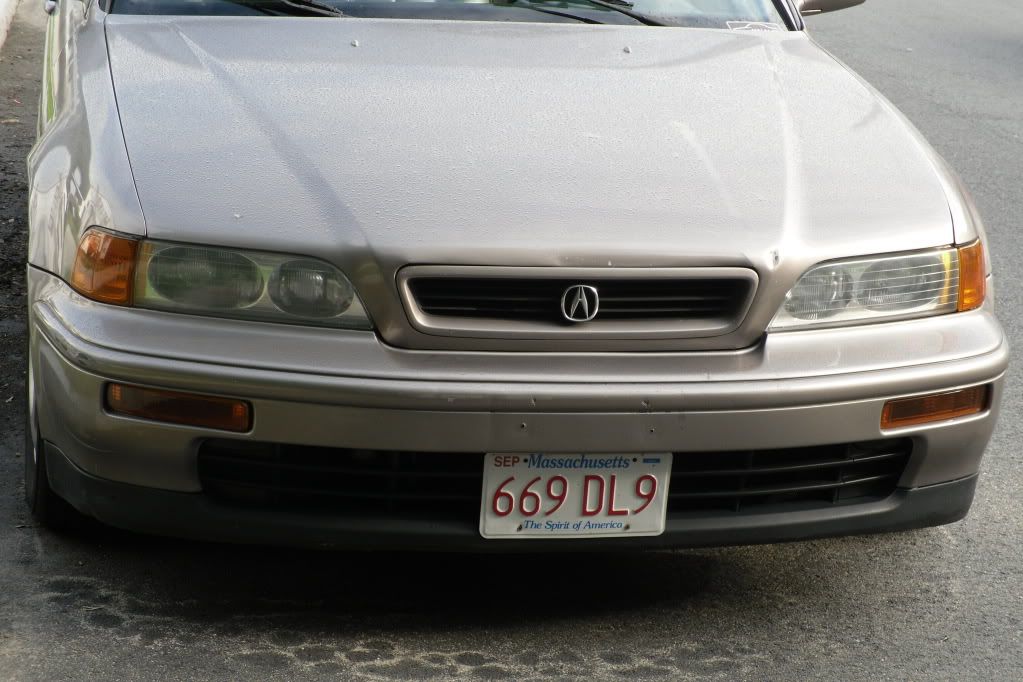

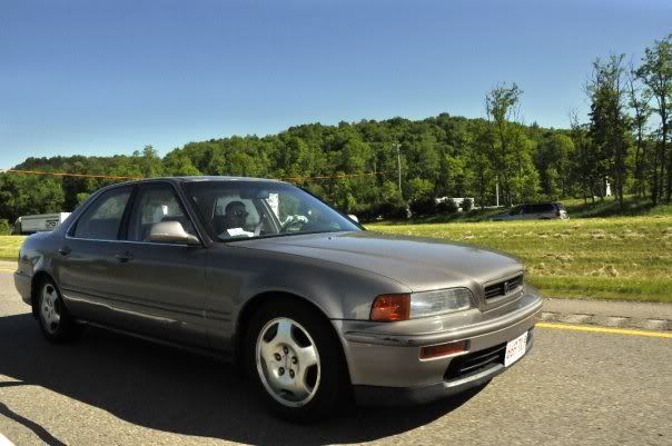

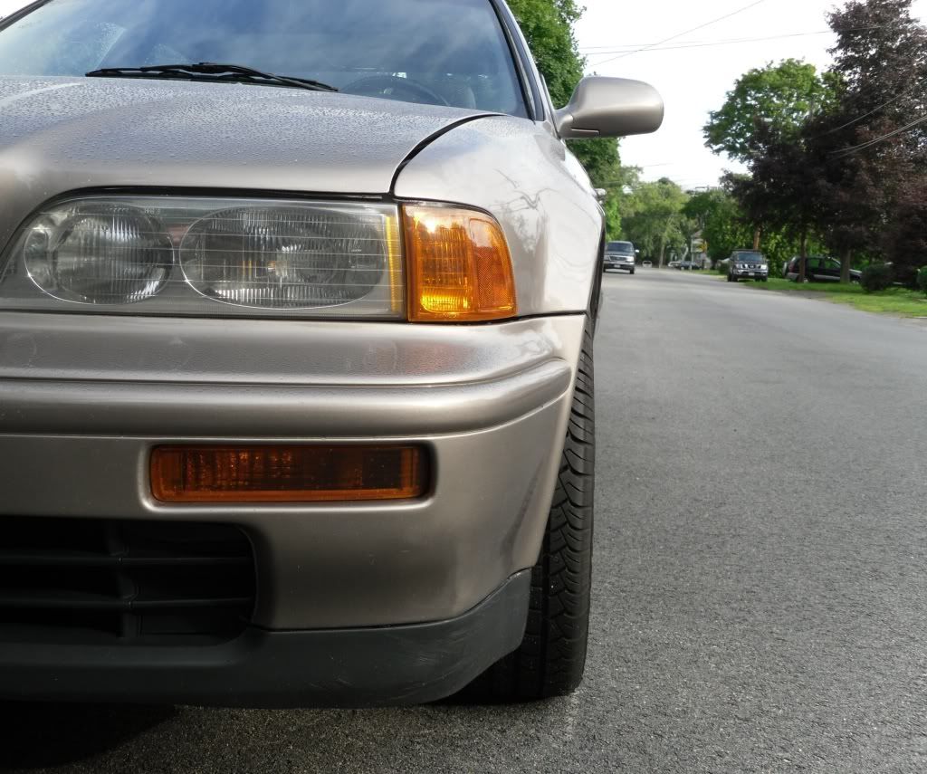

Enjoy your new look and feel as pimp as Mondi
I still need to do one more coat on the reverse lense section to better match the rest of the amber. It looks pretty good in person but its not perfect yet.

the pics are at home i didnt have them uploaded to photobucket yet. I did my rear tails, the corner lights, and the bumper lights...thats why i threw the front up there at the end.
Hang in there they are will be posted up 2nite...i had to get it started at some point!
