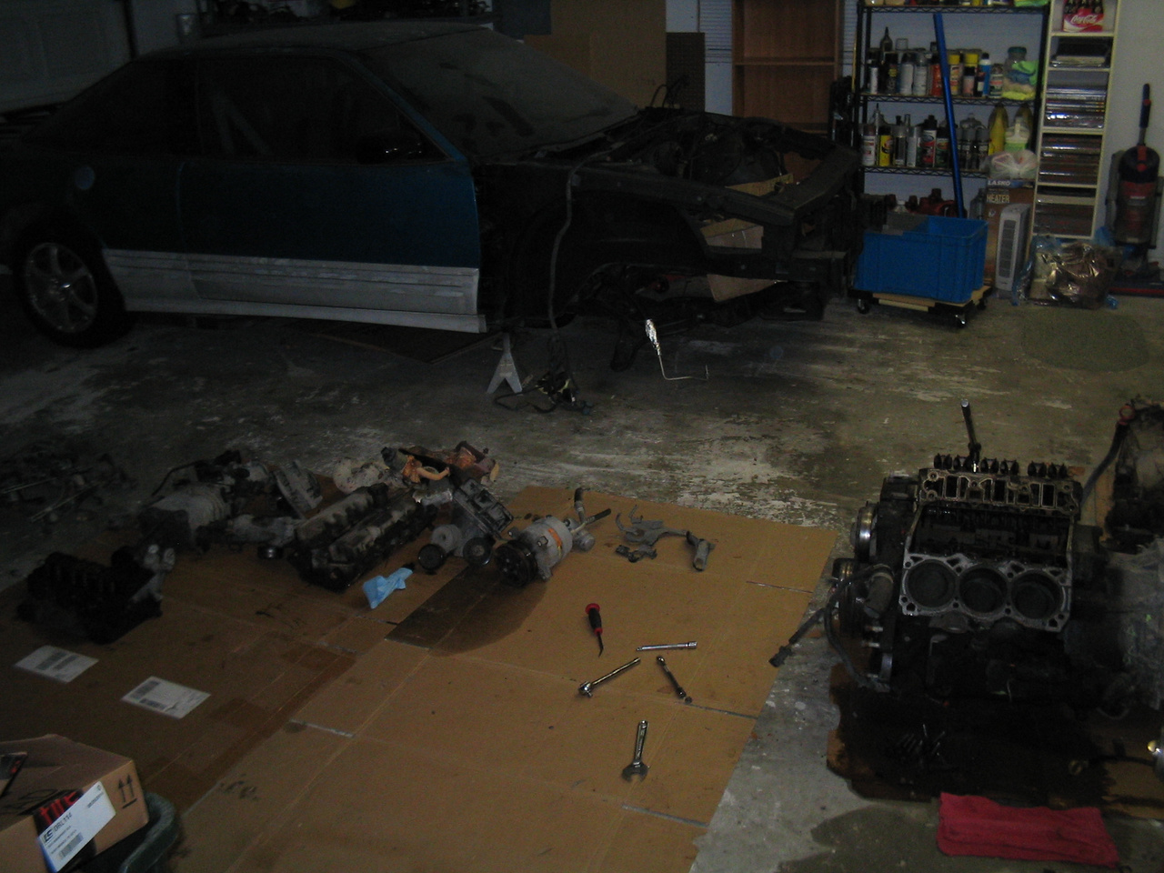

Good news, maybe! I pulled off the SC and the heads today. The heads look like they're alright at first glance There is a lot of debris, but I didn't feel any damage. I'll do a thorough cleaning tomorrow, and take a closer look at them and the SC.
The block is mostly disassembled. I think the only thing I forgot to pull off that I will need is the crank pulley.
Here's the bad cylinder
A pair of grooves worn into the cylinder wall

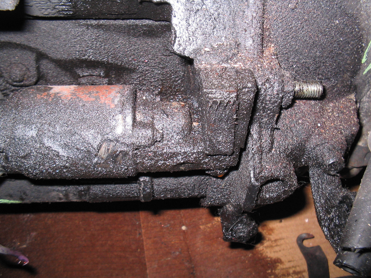

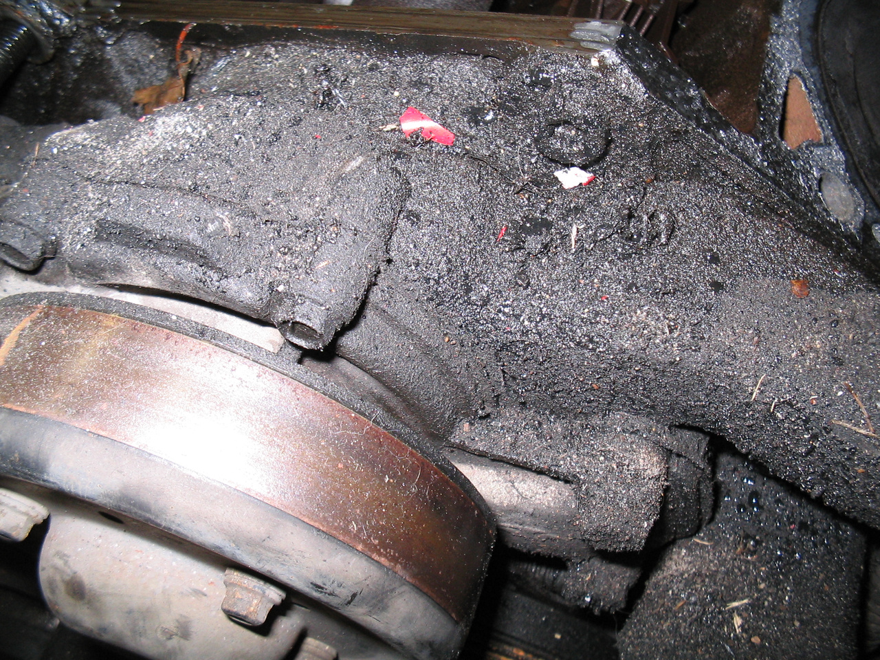

Today I started taking apart the new motor. New. The one that I bought exactly 1 year ago, Labor Day weekend 50% everything sale at the JY. I've removed the supercharger, lower intake manifold, and front cylinder head. I *was* going to just drop the whole thing in as-is, but there was so much filth built up on the top that I would never have been able to install injectors without fearing that I knocked some gunk into the intake. The lower half of the block and transmission is disgusting as well, I may give it a quick wipe-down, at the very least so I can spot any leaks.
To give you an idea of the mess I'm cleaning up... This is on top of the water pump:
And this is the starter solenoid:
