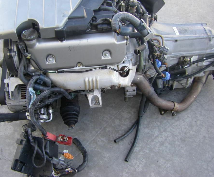

At this point I need to think timeline. I need to do something in safest manner yet...still want to do it once. So I buy an entire JDM 3.5 with a transmission I don't even need just so I can have an engine block with low enough mileage to reuse the bearings if I needed too. (I needed too!)
I tear that down in a day pretty much and bring the heads to the machine shop for Supertech valves, the comp springs, and +1mm Type 2 conversion.
At this point my Type 2 camshafts are still at a grinder for custom CNC cores later. I know I wont get them back in time... so I will install the RL cams for the time being.

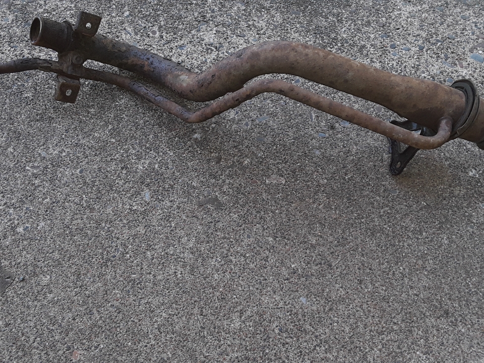

I start spending money on things I shouldn't. Buying doubles of things just to get done in time. Like a used steering rack for one line I don't have and can't make unless I have the fitting. I build the two other lines, buy a high pressure line which has to be modified to fit on our pump , and reinstall the line in the middle in pic below because I don't have enough time to CNC custom fittings for people yet. These lines rust out btw.
Get a non rusting fuel filler to replace this one and install it
