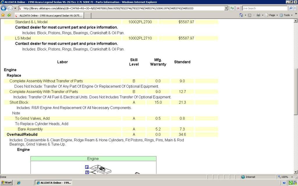

i've never pulled a Legend engine but you should probably set aside about 3 hours it took maybe an hour to pull my trans, but almost three to get it back in.
this is what alldata has to say
