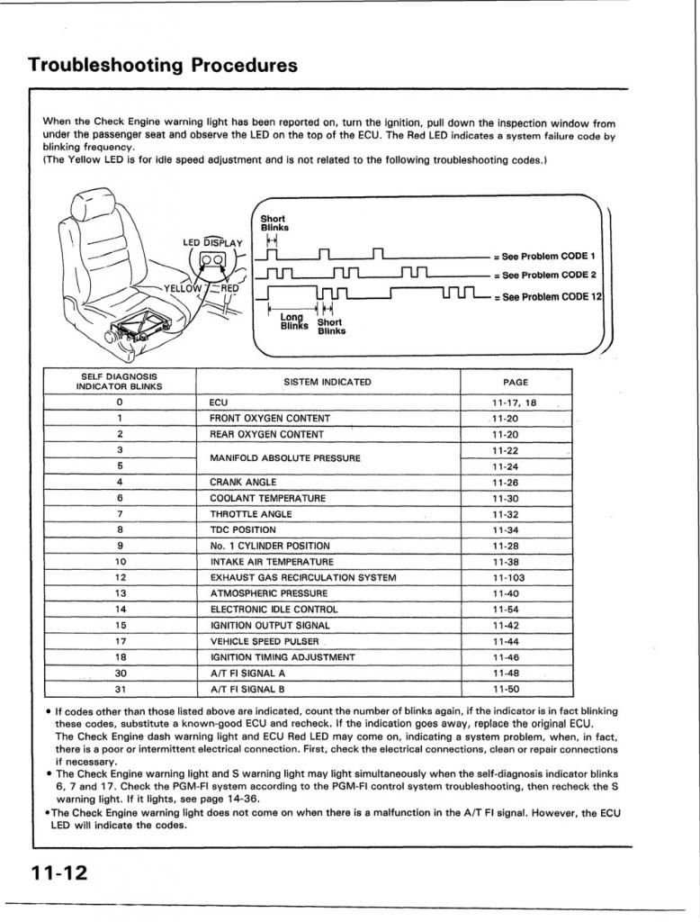

Also, you didn't mention if you have an automatic or manual. If you can, we'll need to see if you are having codes from your ECU. To get to your ECU, you'll need to pull up on the carpet on the passenger side foot well, under the glove box. From there will be a cover. I do not remember if the cover has a site glass on it. If it doesn't, then you'll need to remove the cover to get to the ECU. If it does have a site glass on it, next thing you want to do is place the key to the ON position (engine not running), then you'll need to count the RED blinks and let us know what codes are appearing.
Here's the procedure on how to count it. Ignore the picture of the seat since this is from a Sedan:
