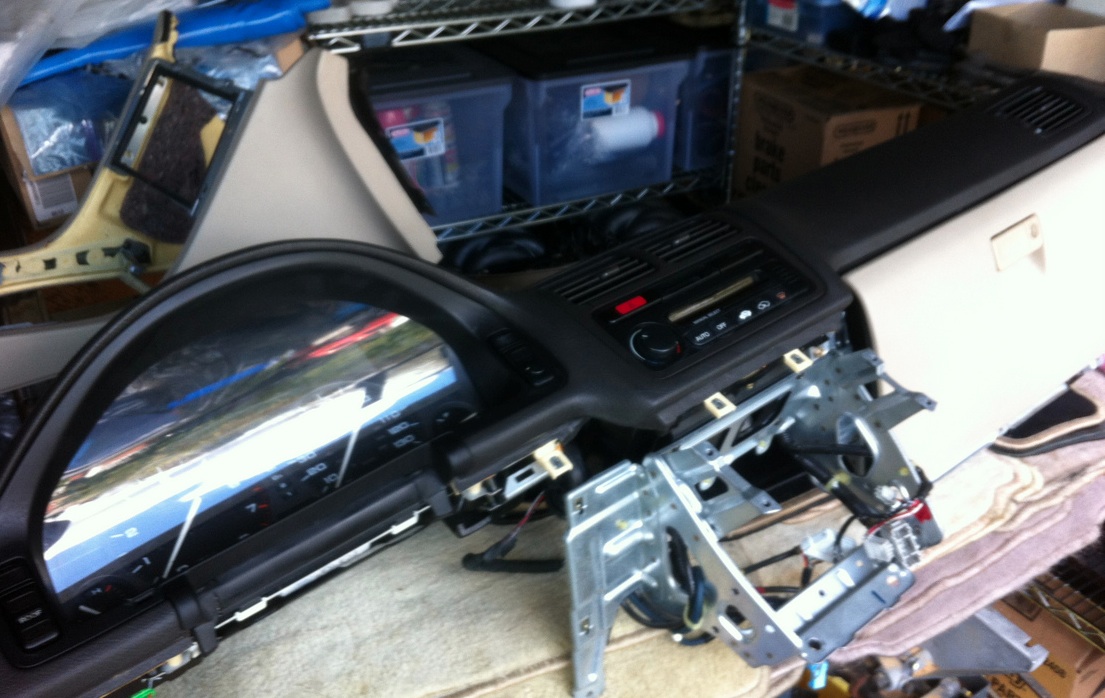

On a bright note I found a flawless dash for it today.

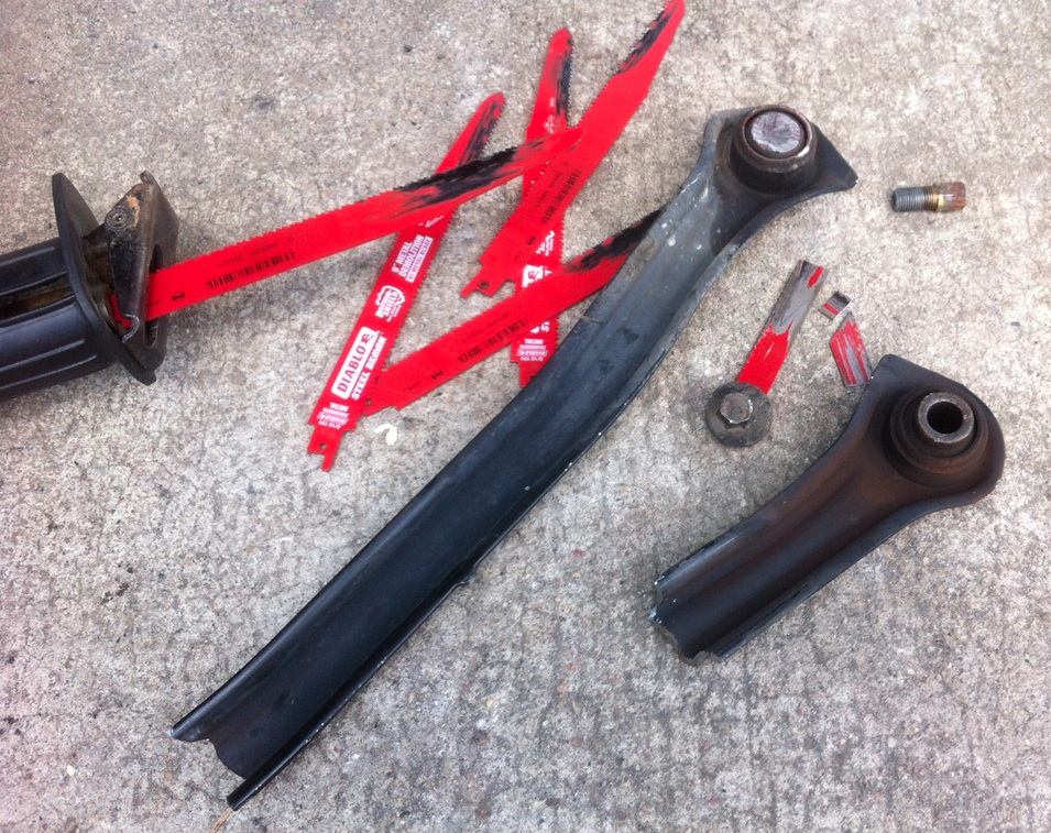

Power Steering rack job was uneventful, but the next job was a little more challenging:

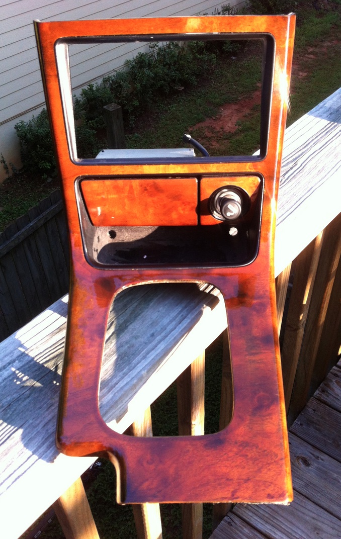

Default Console restored...

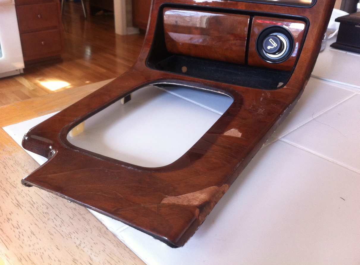

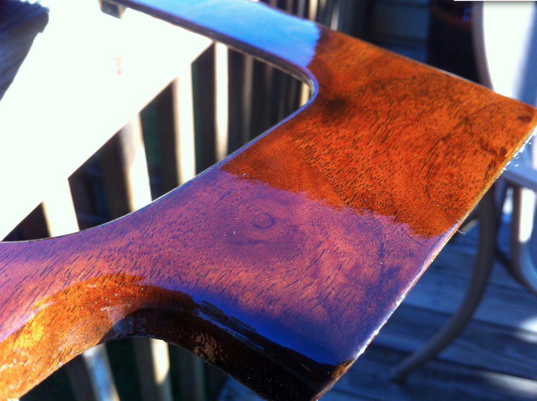

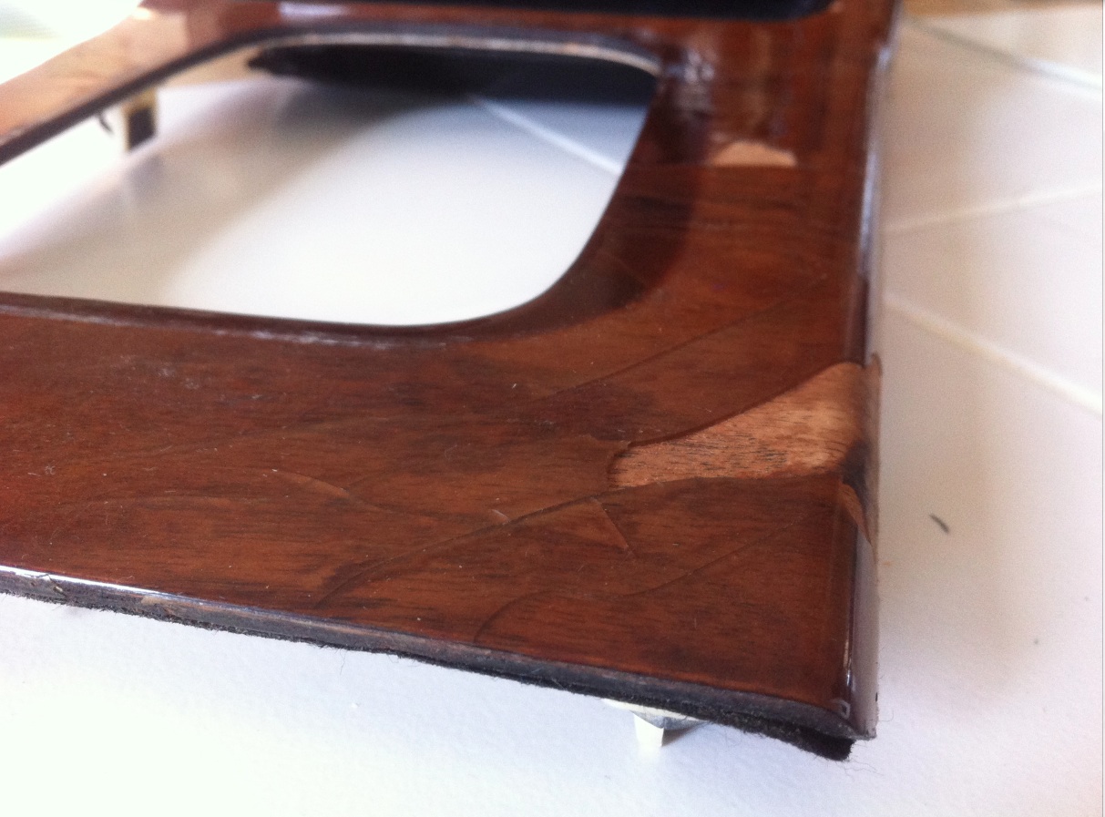

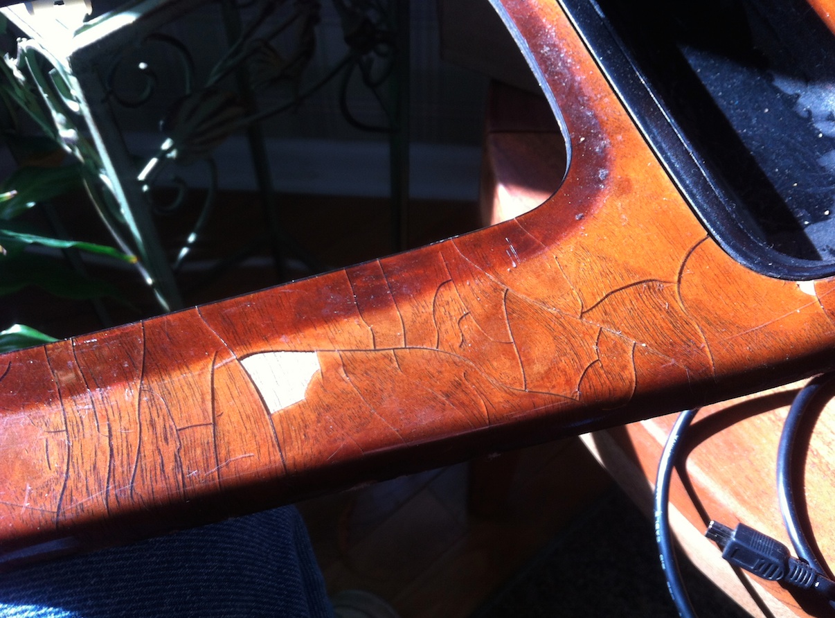

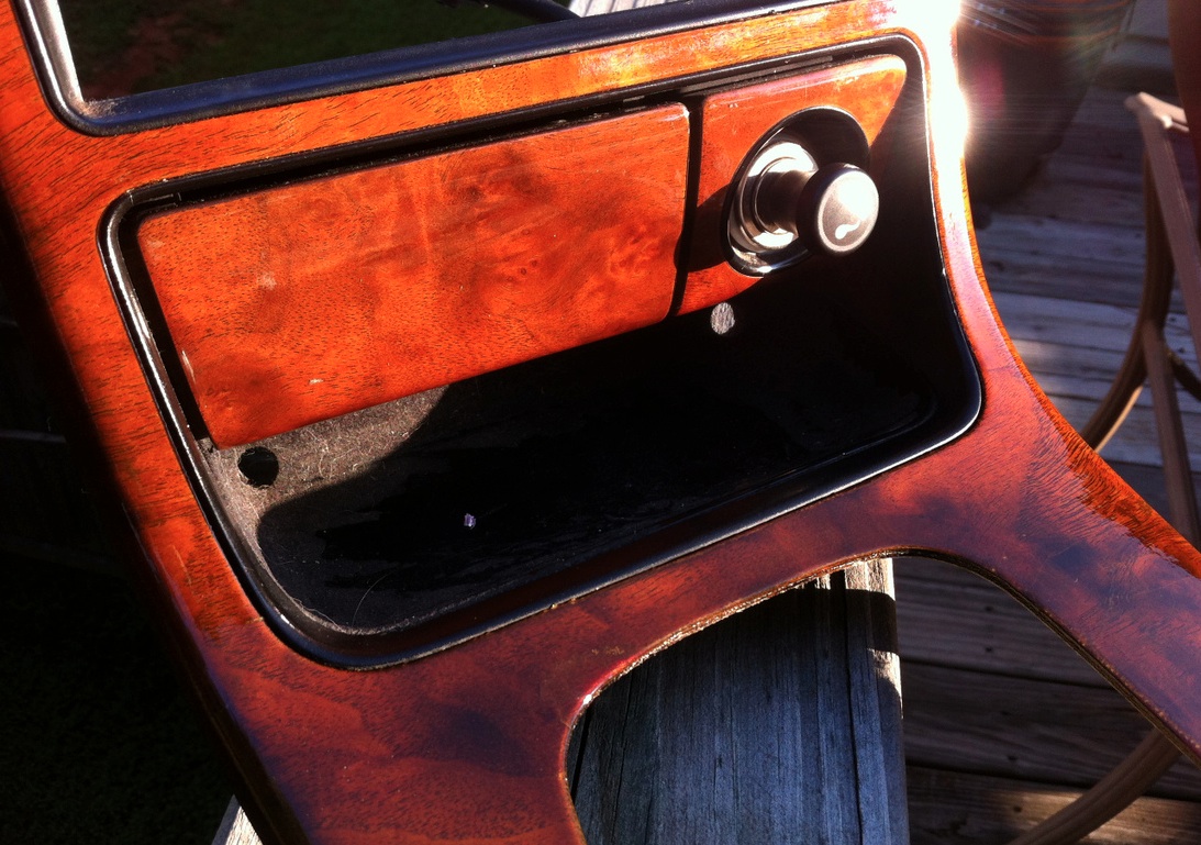

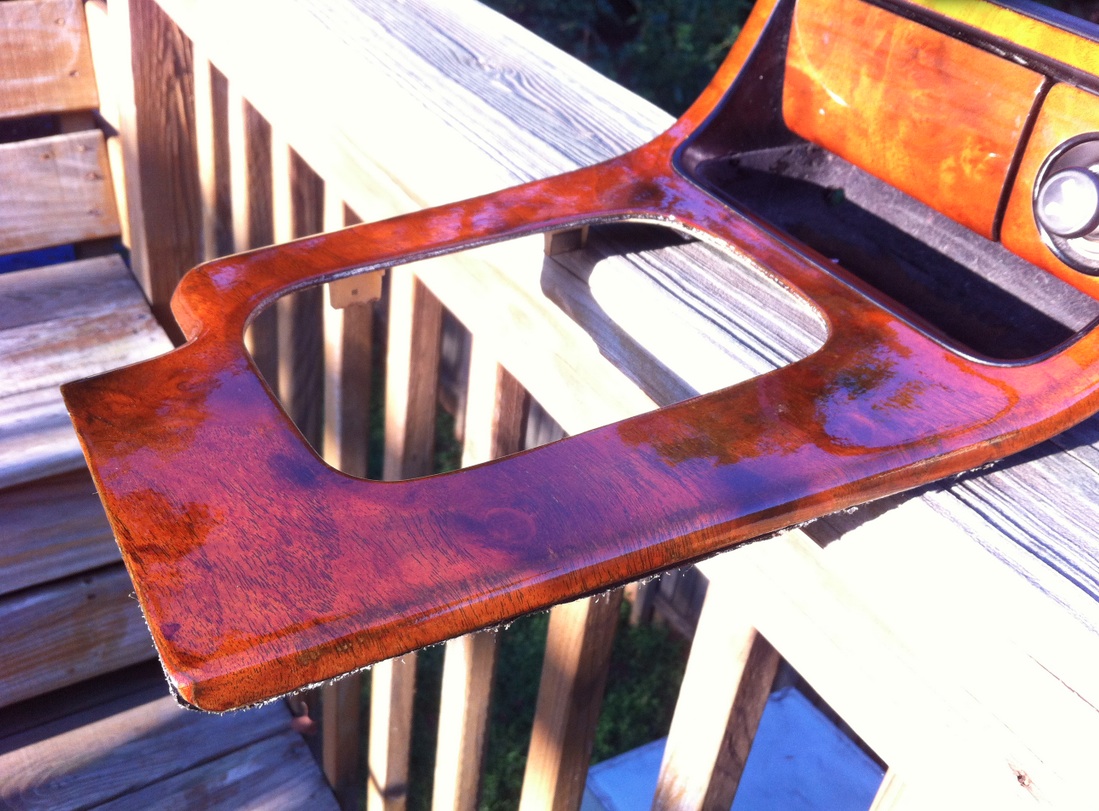

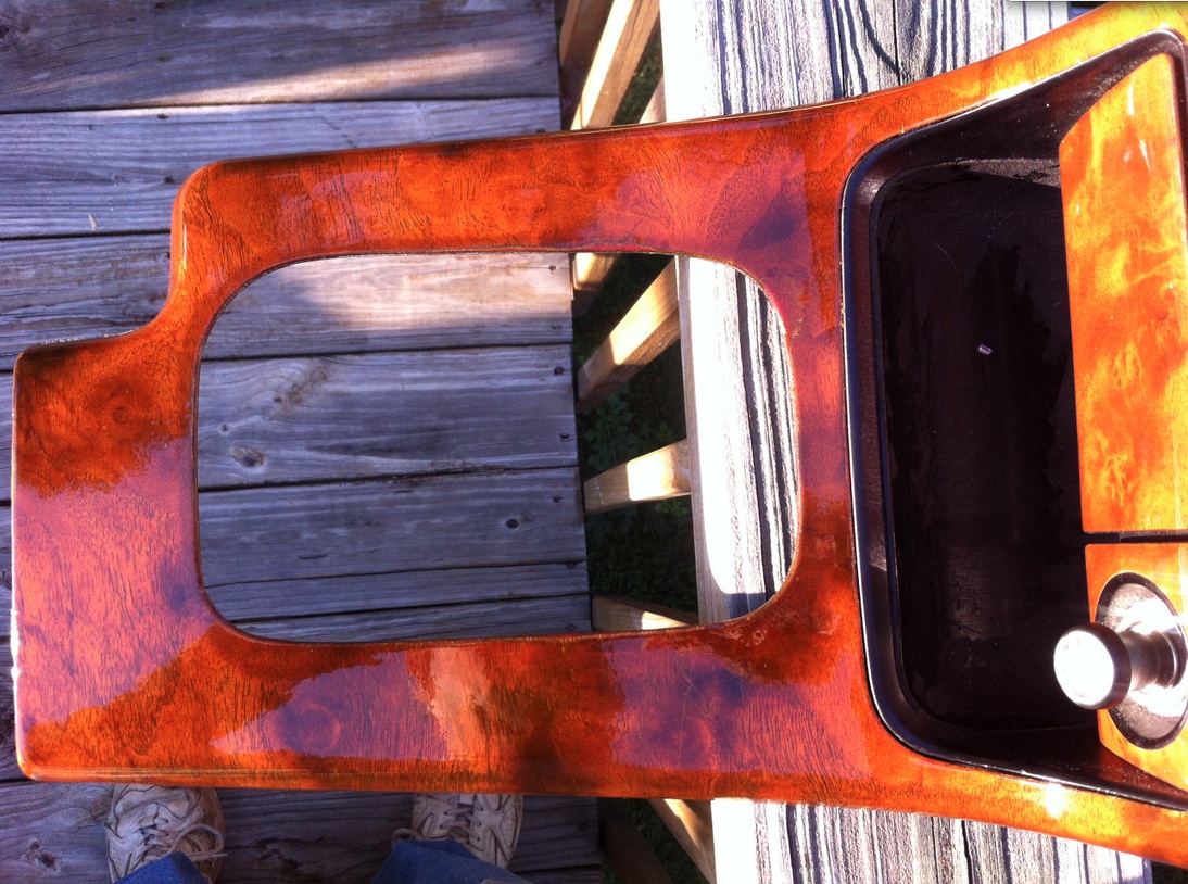

I put a "better" console wood in her a long time ago and have been toying with the restoration of the original beat up console wood.

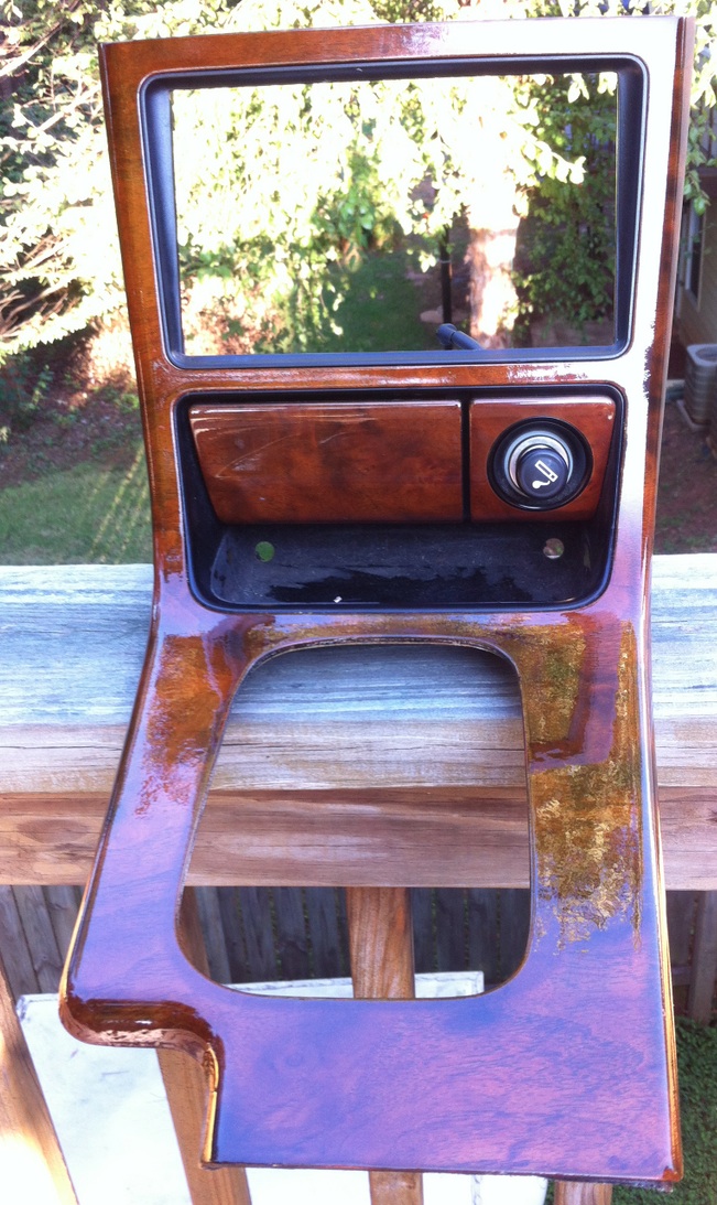

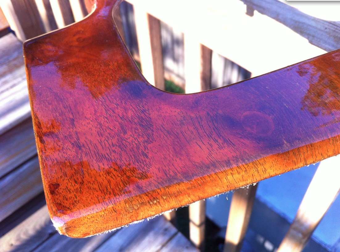

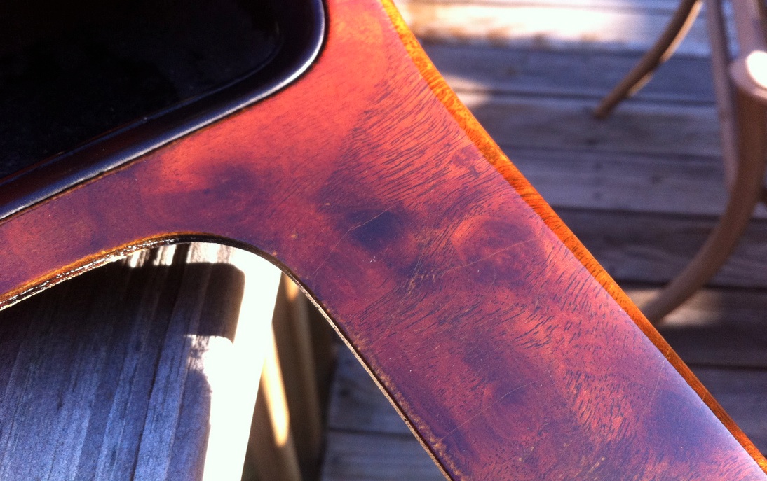

After working with a number of chemical solutions that were total fail I stumbled upon Mercedes/Jaguar folks that have been removing the finish with heat guns. Although the chemical wipedowns had greatly hardened my finish, it came off over time. I did end up with a blemish and some burning while learning the process... but the results are (to me) acceptable.
I'm color blind so I think I got the red tone off a little, but it looks good to me.
Now to see about doing another practice run for the black GS

Originally Posted by One6DSwifflY View Post
Makes the wood look like aged bark. Like old wood floors refinished. Now, do you think that heat gun would melt the alpha console's gold 'legend' inscription off? I've been looking for a way to redo mine without ruining the gold legend lettering on it...
Yup, you take the finish off you take the gold flake off. Thing is, if you can get a good svg repro of the Legend scripted on your console then you can get gold flake decals made... but they are fragile and won't be cheap.
The reason my wood console has the grain definition it does is because instead of tinting the urethane I stained the actual wood. My next experiment will involve tinting the urethane and I will probably brush it on for better gloss control. I don't have a spray system so upon tinting the urethane brush will be my only option. Really the learning curve is removal... the application of a finish is pretty much academic for me and I don't have a huge preference except that I definitely want to use a durable spar urethane since the poly blends supposedly will cloud more over time.

Indeed, the difference in my approach and Evan/Honda's approach is equipment and material. I don't know how many coats Evan is doing... but my console has upward of 15 spray coats on it. With good equipment and a fast drying polyurethane you can lay down the equivalent of about 5 coats in one swipe, but alas I'm hanging around in the old school.
I've seen 2 of Evan's consoles and they are very nice. His price is excellent for the work and results, I'm too broke to pay attention though. (Plus I like the challenge of doing it myself.)
Removing the plastic pieces to prep for removal / application of a finish is especially aggravating to me but we do what we gotta do.
