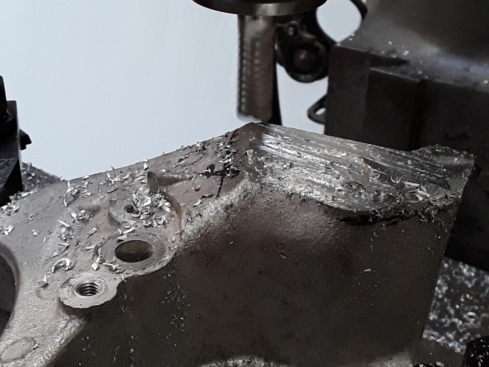

.3.5 mount machined and welded following week.
