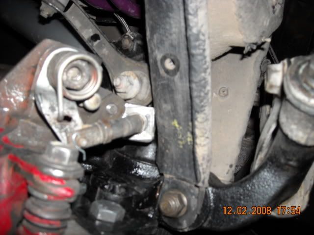

Originally Posted by l4zy415
Lookin' good mayne, does the rear NSX rotor slide right in on the G1 hub?
No, i had to redrill 4 lug G1 pattern on the NSX one...
Hey have you seeing my thread about the brake proportionig valve that i am looking for? i think they came out on 86 and 87's...http://www.acura-legend.com/vbulleti...ponent-130444/

Originally Posted by samblaze
What gauge is that cold rolled steel for the bracket? Will it hold up to the stress forces generated by the caliper? Although it is the rear so there sholdn't be as much stress as the front..
Is 1/4" thick is holded by 2- 10m x 1.25 bolts, i am thinking i do some test runs to the brake upgrade to see if nothing comes lose and maybe just use thread locker on the bolts or spot weld the bolts on the bracket since this bracket does not need to be removed to service the brakes or any of the wheel area components...

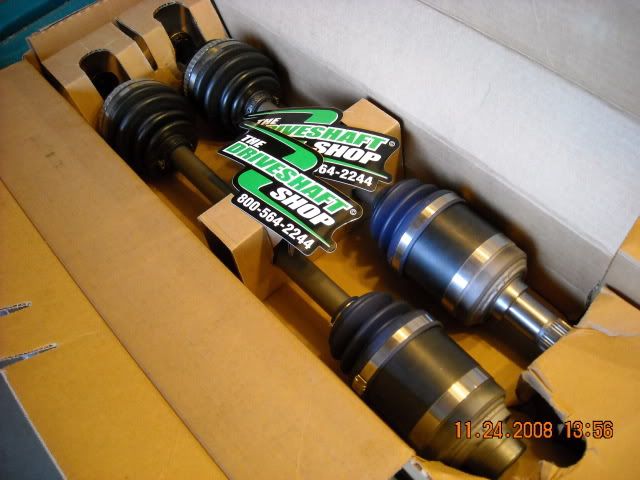

Finally I got level 5 CV joints from the drive shaft shop already test fit and they are ok now is just remove engine for the engine bay cleaning and paint and installing item that need to be install with out the engine (easier) like brake lines and fuel lines etc.
Aww sweet. Is that the custom made drive shaft?
Yes they took almost a month and a half to deliver those to me, they said is because they have a lot of orders but they are here so I guess no big deal...

Originally Posted by dblanehopr
how much do those run?
These are a custom made level 5 NSX to Legend CV joints I had quotes from several companies that specialize in this trade range from 600.00 a set to 1100.00 but the driveshaf shop had the best communication and a mid point quote and better reviews and for some reason they made me feel secure about the deal... well I paid 790.00 + shipping

Originally Posted by 92drls
Lol I think he meant how much for the aftermarket dash?? I got some axles from driveshaft shop for my ol' GSX, their good people!!
He is asking for the CV joints check his quote, display run about 1000.00 more or less...

Well enogh of that, I got my WRX rad for the custom fit project dimensions are perfect top and bottom brackets are in the wrong place but no problem I can make custom fit bracket , drain fitting is on the wrong side I think there 2 options one get a aluminum bung and move the fitting to the back or just cut a notch on the car bracket to access the fitting, hose connections are not really big problem top is right on the same location as the G1 rad bottom is to the side 3' off the G1 location but I figure that this not a problem maybe just need to weld a 45* fitting to have easy access to the hose...
Here is a pic of th rad pre-installed.
Also I have good news for the rear NSX brake upgrade I figuered how to make a custom bracket for the e-brake cable and make work, so I have e-brake now here are a couple of pics of the rear brake set up.
