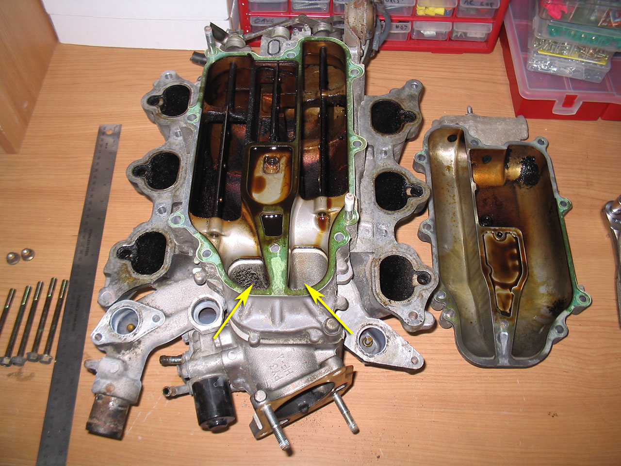

Put the biggest throttlebody on there you want, it's not going to make a difference... The air still has to be pulled through these tiny little ports.

Since the intake system is already tuned you are going to keep hitting bottlenecks. By continuing through the path you will end up starving at the valves too right?
15 years ago there might be enough interest for you to pursue designing a performance intake and some valvetrain mods, but at this point it's going to end up being academic at best I think.
I remember that people have bored the TB, intake manifold and runners to open up a path to heads and removed the VIS but I don't know that any appreciable HP gains were ever disclosed.
If it suits you keep pushing through for your own satisfaction. Innovation might be too late for large adoption, but who knows.
