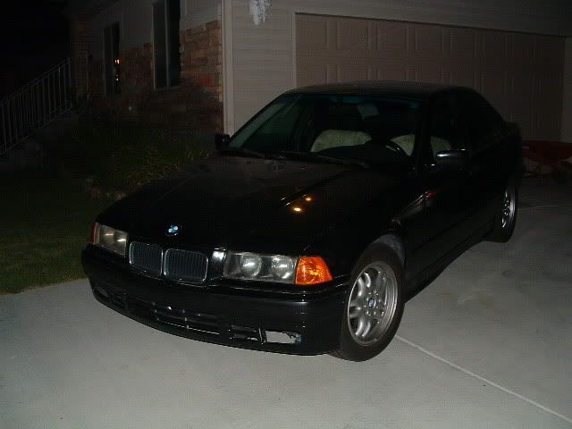

In its near future condition I don't think traction will be an issue as it will look like this
(not mine but same engine looks exactly like mine)
