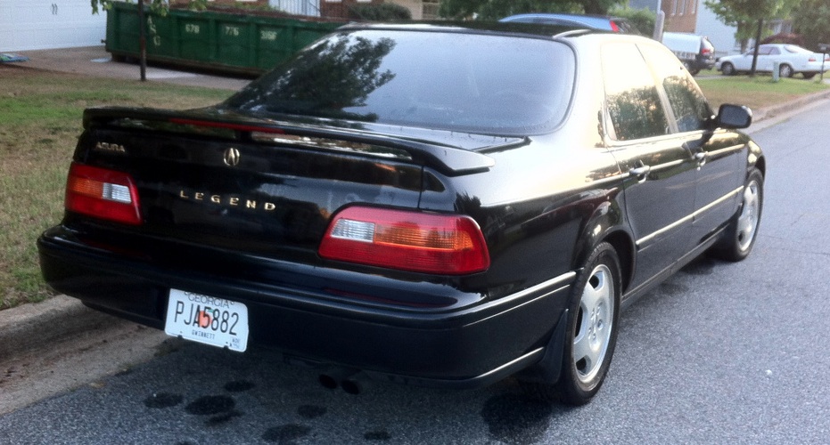

thanks you have any rear shots of your car showing the wheels?

Old 04-04-2015, 09:11 PM   #6

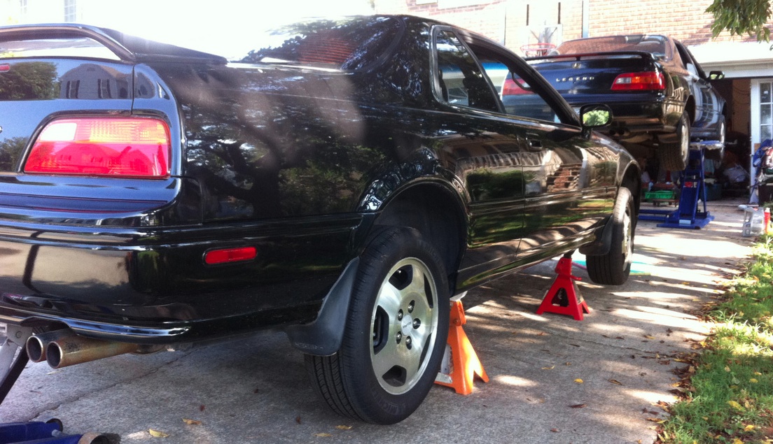

This is the only rear shot I have, I just checked and they are 225/50-16. (I put them on my stationary coupe)
Here is the day I swapped them with my coupe tires/wheels: 225/50-16 still on the GS in this pic:

haha, nice lift you have there. I need one of those bad!
I think I'll roll with the 225/50-16s.
