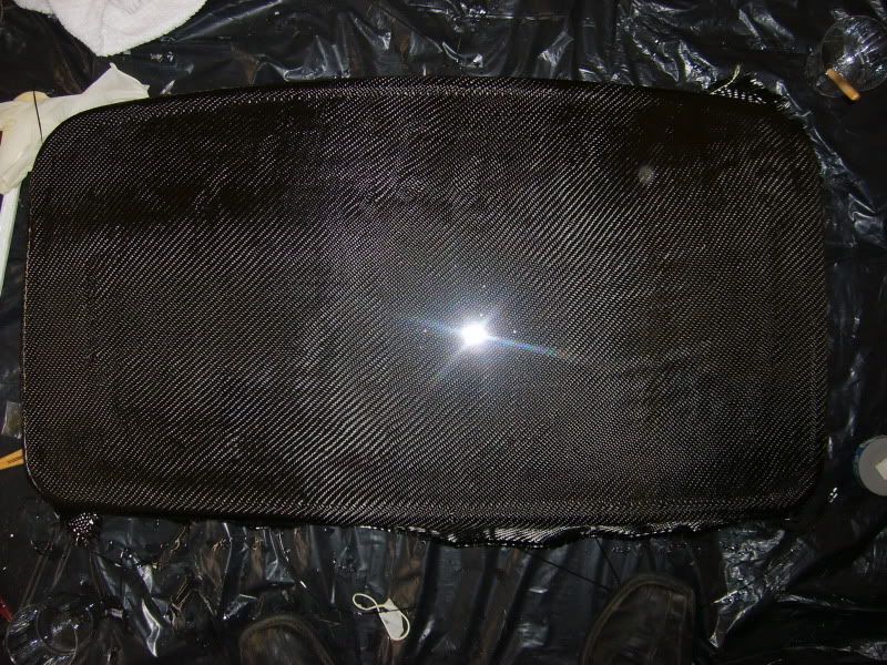

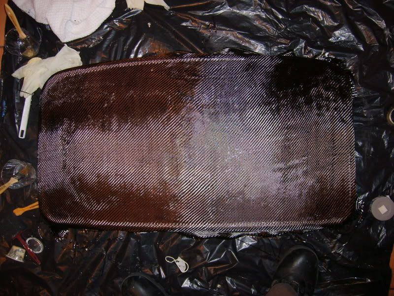

Here it is in the first stages...
So, I've got it planned out so it will mount into the hole with factory hardware and will replace the entire assembly. It will also allow the headliner to stay in if desired. It will include a drain pan and tie into the factory drain tubes. I've got my headliner and all the sunroof junk out and it was heavy.
Not only will this reduce an estimated 50 lbs of weight, (I haven't weighed it yet) my theory is, this will also lower the center of gravity of the car and improve handling.
This will be made out of 3 layers of 5.7oz 2x2 weave of carbon fiber.
Pricing to be determined.

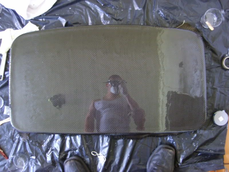

You guys are crazy... Now it looks good. (It'll look even better when it cures too)
Look at that reflection...

"look at that reflection" Just a little proud are we? lol. but on the real it looks great.
