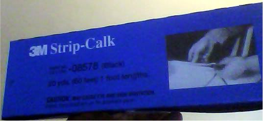

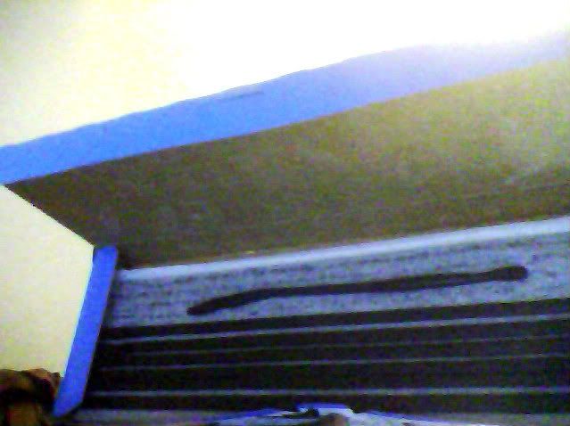

I just looked in the trunk and the the driver side tail light is letting the rain water in. Where can I buy the black sealant?
Old 09-08-2011, 10:59 PM   #4
for anyone interested 3m model # 08578 non hardening strip caulk.

yes Sir, it cost 25.00 a box and I have plenty left over. If you want to buy a couple strips instead of wasting 25.00 holla at me.
This is the same stuff the manufacturers use. The problem with our cars is the gasket is foam and it cracks from over tightening and over time starts to deteriorate.
