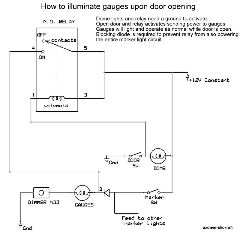

I want to wiring up my LED gauge with my doors so it will liiuminate when I open the door like the new Acura's. So far I have managed to get this diagram which is can probably figure out but was wondering if anyone here has done this before??

You have a alarm right? I've been reading the viper 5900 manual all night and seems this is possible... just tap the dome light and it will light up.
Now don't ask me anything else on the subject cause I gotta figure out how to get my dome to work haha

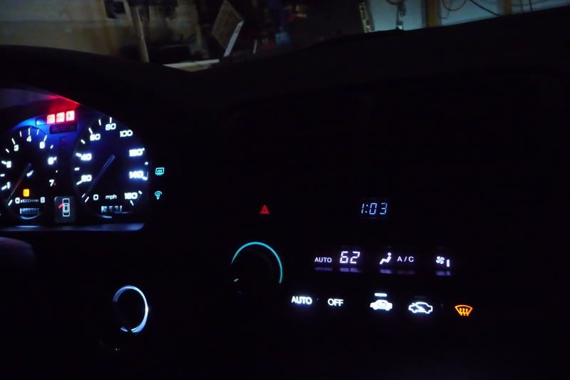

Roger - post some pics of your "led" gauges!!!
Seriously??? they are all over the forums u havent seen them?

I have seen them I just love seeing different variations. did you ever try getting a set of glowinig needles to work???
I will say very nice work. Any more pics? or DIY ?
