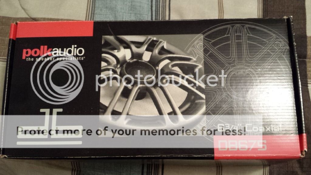

I would grab my old stock speakers and measure them again had I not sold ALL my original Bose system years ago. I do know for a certainty they were 6 3/4" in size. In fact here are the direct fit no adapters needed Polk speakers I've been running for around 8 - 10 years or so.
In fact my old Crutchfield records show I bought 6 3/4" adapter plates in March 2004 and they're still in the packaging unused. I even found reviews on Crutchfield from 2005 - 2007 which seems about right for when I bought these.
http://www.crutchfield.com/p_107DB67...er-reviews-tab
